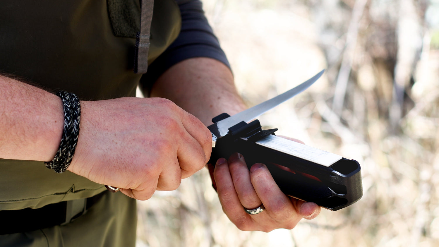

Best Overall Value: Wicked Edge Venture WE20 ($40)
Why It's Perfect for Filet Knives: The WE20 was specifically engineered to handle flexible blade geometry, making it the top choice for budget-conscious anglers.
Key Advantages:
  • Specialized flexible blade handling system
  • Ultra-portable design (fits in tackle boxes)
  • Optimal pressure distribution prevents blade damage
  • Field-ready for boat and stream sharpening
  • Unbeatable $40 price point

System Setup - Venture Series:
  1. Choose 15 or 17 degree Knife Guides (most filet knives)
Step 2: The Critical Sharpening Technique

Grit Progression Strategy - Venture Series:
  • Very dull/damaged: Start with Diamond Stone
  • Moderately dull: Begin with the Ceramic Stone
  • Touch-up sharpening: Start with the Leather Strop
  • Always finish: Finish with the Leather Strop
