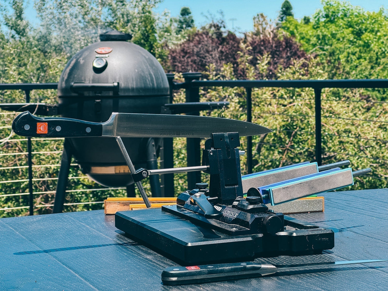

Boning/Fillet Knife
This is my go-to for trimming fat and prepping cuts. I like to sharpen it to 1000 grit,
followed by a light strop. It gives me just the right balance of bite and control. I almost always use the Blade Stabilizer here—flexible blades like this really benefit from the extra support. If I don’t feel like getting out my whole system, I’ll get out my Venture sharpener to get the job done quickly and precisely.
Carving Knife
When it’s time to slice into that brisket or turkey, my carving knife is ready. I also take this one to 1000 grit and give it a light strop to make sure it glides cleanly through the meat. Again, the Blade Stabilizer makes this process easy and consistent, and I’m also always happy to use my Venture for this one as well. It’s obviously a longer knife, but the Venture still handles it with ease.
Chef’s Knife or Nakiri
For sides and veggies, I turn to either a classic chef’s knife or my Nakiri. These get a bit more polish:
Chef’s Knife: 1500 grit finish
Nakiri: 3000 grit, because I like that extra smooth push-cut for slicing vegetables
I don’t usually use the Blade Stabilizer for these, but that might just be personal preference. It certainly wouldn’t hurt, and the Venture sharpener is more than capable of dialing in a fine edge here too, but I tend to prefer my main system for these.
