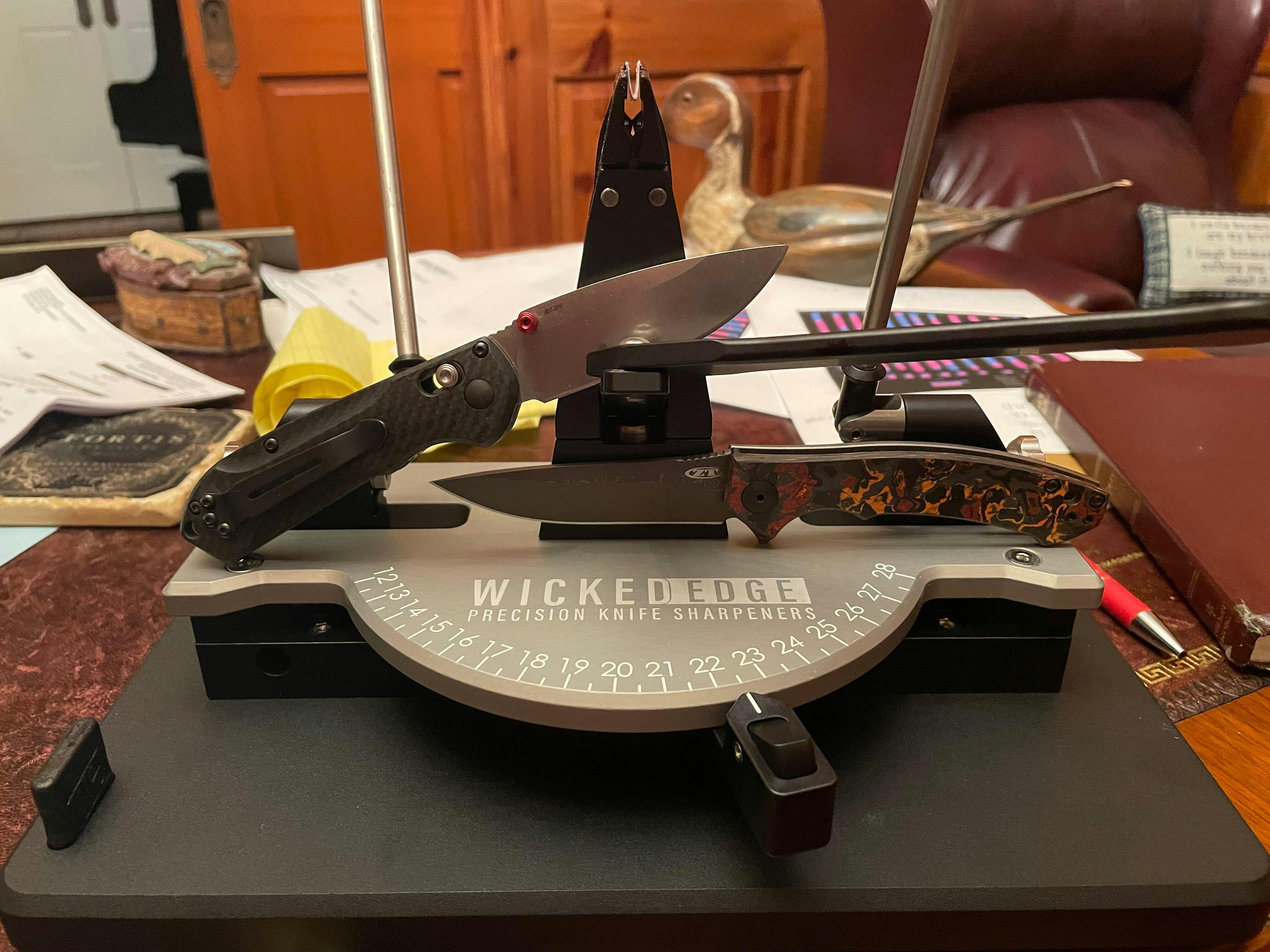

How did you prep your knives in terms of the angle you chose for each?
"I matched the angle on the knives. I don't like to re-profile knives because I don't like to remove the material from them and I also like to keep their factory appearances. My spartan is at 27 degrees per side, the Kramer edition Henkel was sharpened at 15 degrees per side, the benchmade is sharpened at 24 degrees per side, the Leatherman at 20 degrees per side, and the other Chef's knife was sharpened at 22 degrees per side."
