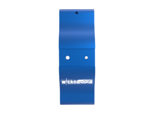

Looking to securely mount your Wicked Edge sharpener with the standard blue base? This guide walks you through the process of using our downloadable template to mount your sharpener to a bench or custom platform. Whether you're setting up a permanent sharpening station or customizing your work surface, this method ensures a stable and precise setup.
Important: The 10/32 x 1-1/2″ screws included with your sharpener are designed for surfaces approximately 1-1/4″ thick. If your surface is a different thickness, be sure to adjust accordingly. For quick setup, you can also browse our ready-made mounting options here: Mounting Bases.
Instructions for Using the Mounting Template
- Download and print the template: You can find it here.
- Trim the template: Cut along the solid outer border to match the exact size of the sharpener’s blue base.
- Position the template: Mark the vertical and horizontal centers of your mounting surface. Place the template where you'd like to mount the sharpener. Use a ruler or T-square to align it and tape it down to hold it in place.
- Drill mounting holes: Use a 13/64” drill bit centered on each marked hole (there are two, in opposite corners) and drill straight down.
- Optional: Countersink the bottom: Use a 3/8” bit or countersink tool on the underside of the platform to accommodate the screw heads.
- Install the screws: Insert the mounting screws through the bottom of your surface and into the base. If needed, add washers to improve the fit.
