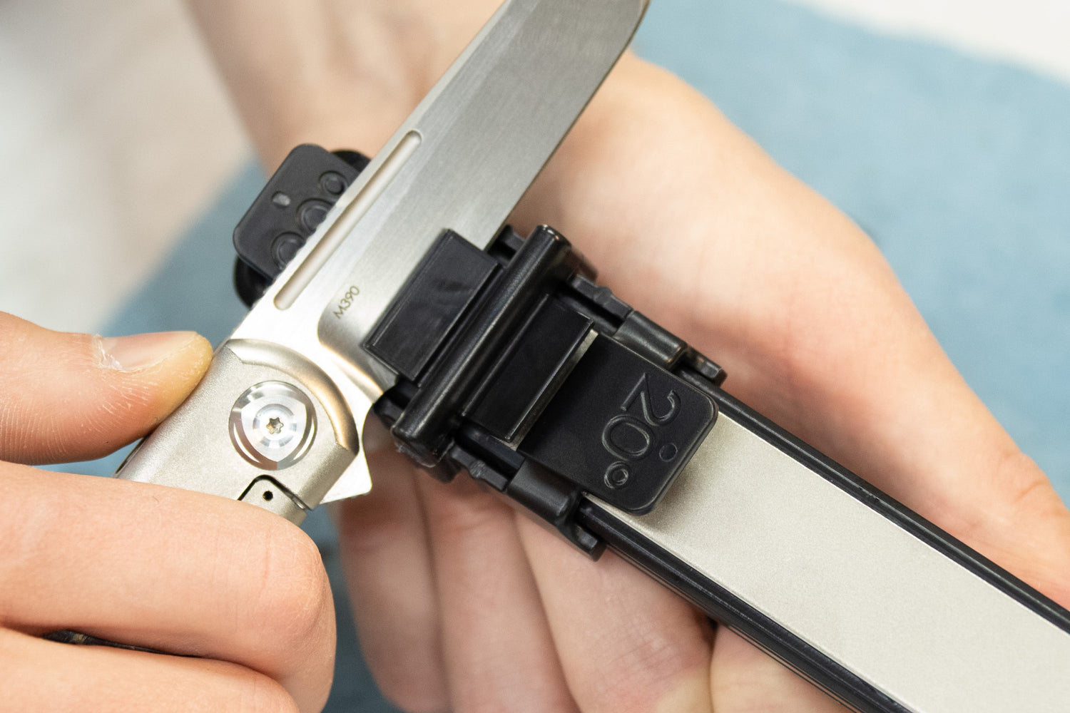

Expert Techniques for Optimal Knife Guide Performance
After sharpening hundreds of knives on WE20 systems, we've identified two key techniques that ensure smooth, effortless guide movement:
Technique 1: Spine Lift Method
When pushing the blade forward, gently lift the knife's spine slightly. This relieves downward pressure on the Guide without actually breaking contact between the blade and the guide surface. You're aiming for the point just before the blade would lift off.
Technique 2: Maintain Level Throughout Stroke
Keep your blade perfectly level during the entire sharpening stroke. Avoid dropping or raising your wrist, which creates uneven pressure and resistance.
