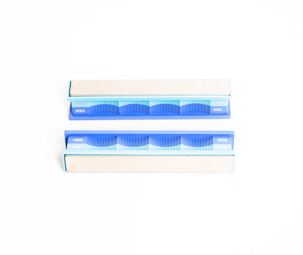

Step 6: Progress Through Grits
After forming a burr on both sides, move to the next higher grit. Do about 15 alternating, edge-leading passes per grit. Over time, you'll learn to hear and feel when it’s time to switch grits.

Touch-Up Instructions
One of the major advantages of Wicked Edge sharpeners is the ease of touch-ups. With your knife positioned using previously recorded settings, simply do 15 alternating edge-leading passes per side with your finishing grit. For example, if you ended your last session at 1000 grit, use 1000 grit again. You only need to recreate the burr if you're not satisfied with the sharpness or are repairing damage.
