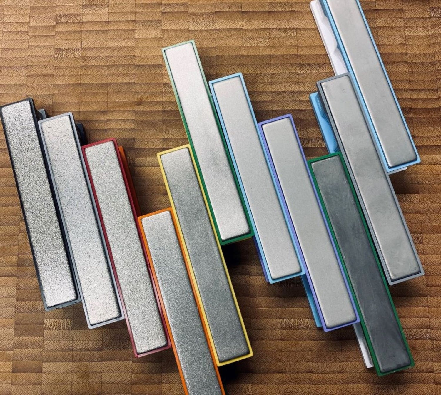

A working edge is usually finished with mid-level stone, either the 600, 800, or 1000 grit Diamond Stones. These stones leave micro-serrations on the edge, allowing this edge to bite in and cut through tough material. This finish is a favorite for us here at Wicked Edge when we’re working in the warehouse and have to cut through plastic, boxes, and tape.

If the highest grit you have is 1000 Grit Diamond Stone > 9-Micron Lapping Film > 6-Micron Lapping Film > 4-Micron Emulsion on Leather Strop > 2-Micron Emulsion on Leather Strop
If the highest grit you have is 1500 Grit Diamond Stone > 6-Micron Diamond Lapping Films > 4-Micron Emulsion on Leather Strop > 2-Micron Emulsion on Leather Strop
If the highest grit you have is 2200 Grit Diamond Stone > 6-Micron Diamond Lapping Films > 4-Micron Emulsion on Leather Strop > 2-Micron Emulsion on Leather Strop
If the highest grit you have is 3000 Grit Diamond Stone > 3-Micron Diamond Lapping Films > 1-Micron Emulsion on Leather Strop > 0.5-Micron Emulsion on Leather Strop
