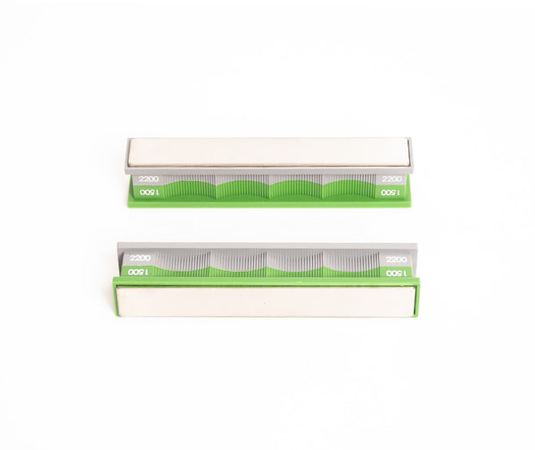

Wicked Edge Grit/Micron Order Chart
This chart lists abrasives from coarsest to finest. It is not a suggested sharpening sequence.
Wicked Edge Grit/Micron Progression Chart
This chart shows the actual recommended sharpening order—moving from coarsest and hardest to finest and softest abrasives.
